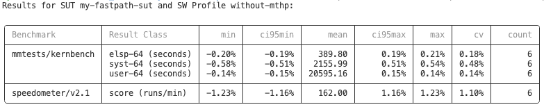

First, let’s look at the summary statistics for all the benchmarks of a single swprofile for a single sut. There is only a single sut in the resultstore so it is implicitly used. We specify the single swprofile we would like to view results for and specify that we want to see the summary statistics relative to the mean. The resulting table shows min/mean/max as well as the confidence interval bounds (95% by default but this can be overridden), the coefficient of variation (that’s the standard deviation expressed as a percentage of the mean) and the number of samples:
fastpath result show results/ --swprofile without-mthp --relative
To restrict the analysis to results generated by a specific user, add --user. The option may be specified multiple times:
fastpath result show results/ --swprofile without-mthp --relative --user alice
../_images/fastpath-result-show-single.png

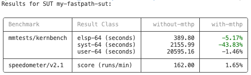

Now let’s compare results between 2 swprofiles. This time we get a summary table that compares the means, and if there are any statistically significant changes, regressions are highlighted in red and improvements are highlighted in green. Here we can see that enabling 64K mTHP in the kernel improved the kernbench benchmark by 5.17% on average. The speedometer benchmark also improved by 1.65% on average, but this is not deemed statistically significant so it is not highlighted.
Note
A change is considered statistically significant if the confidence intervals (95% by default but this can be overridden) for the 2 results being compared do not overlap. Additionally the comparison mean must be beyond noise-threshold percent of the baseline mean. The noise-threshold can be specified but defaults to 1%. Whether a change is considered an improvement or regression depends on the measurement. For example times usually improve when they get smaller, rates usually improve when they get bigger.
fastpath result show results/ --swprofile without-mthp --swprofile with-mthp --relative
../_images/fastpath-result-show-multi.png
fastpath result show supports a number of ancillary options. For example, we can print the table using only ascii characters. In this case, only ascii characters are used and instead of coloring the output for improvements and regressions, the symbols (I) and (R) are displayed. This can be useful for plain text email and for people with color blindness. Additionally you can filter the results to show only improvements (See fastpath result show --help for more options):
fastpath result show result/ --swprofile without-mthp --swprofile with-mthp --relative --format ascii --display improvement
Results for SUT my-fastpath-sut:
| Benchmark         | Result Class      |   without-mthp |   with-mthp |
| mmtests/kernbench | elsp-64 (seconds) |         389.80 |  (I) -5.17% |
|                   | syst-64 (seconds) |        2155.99 | (I) -43.83% |
